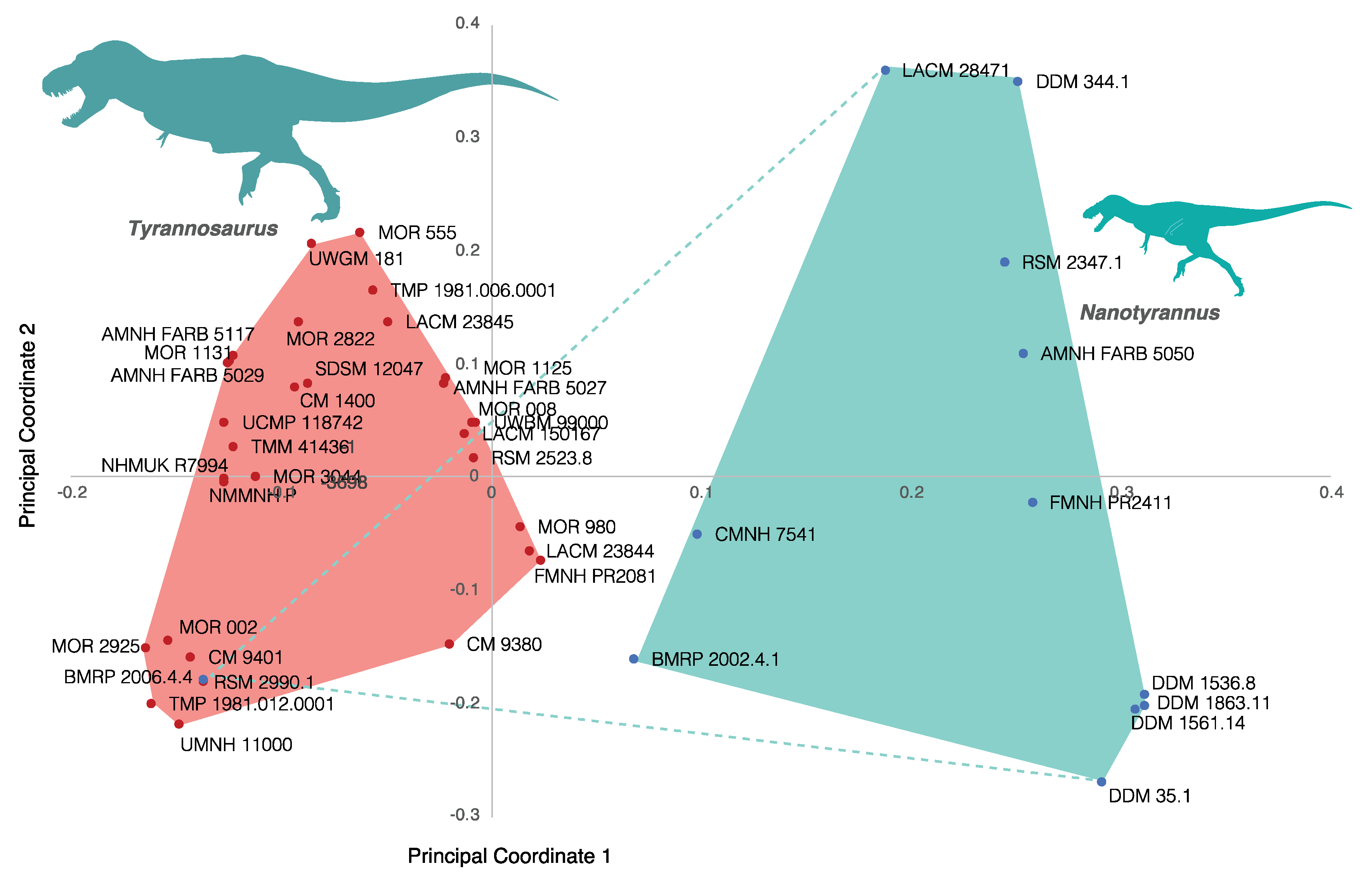

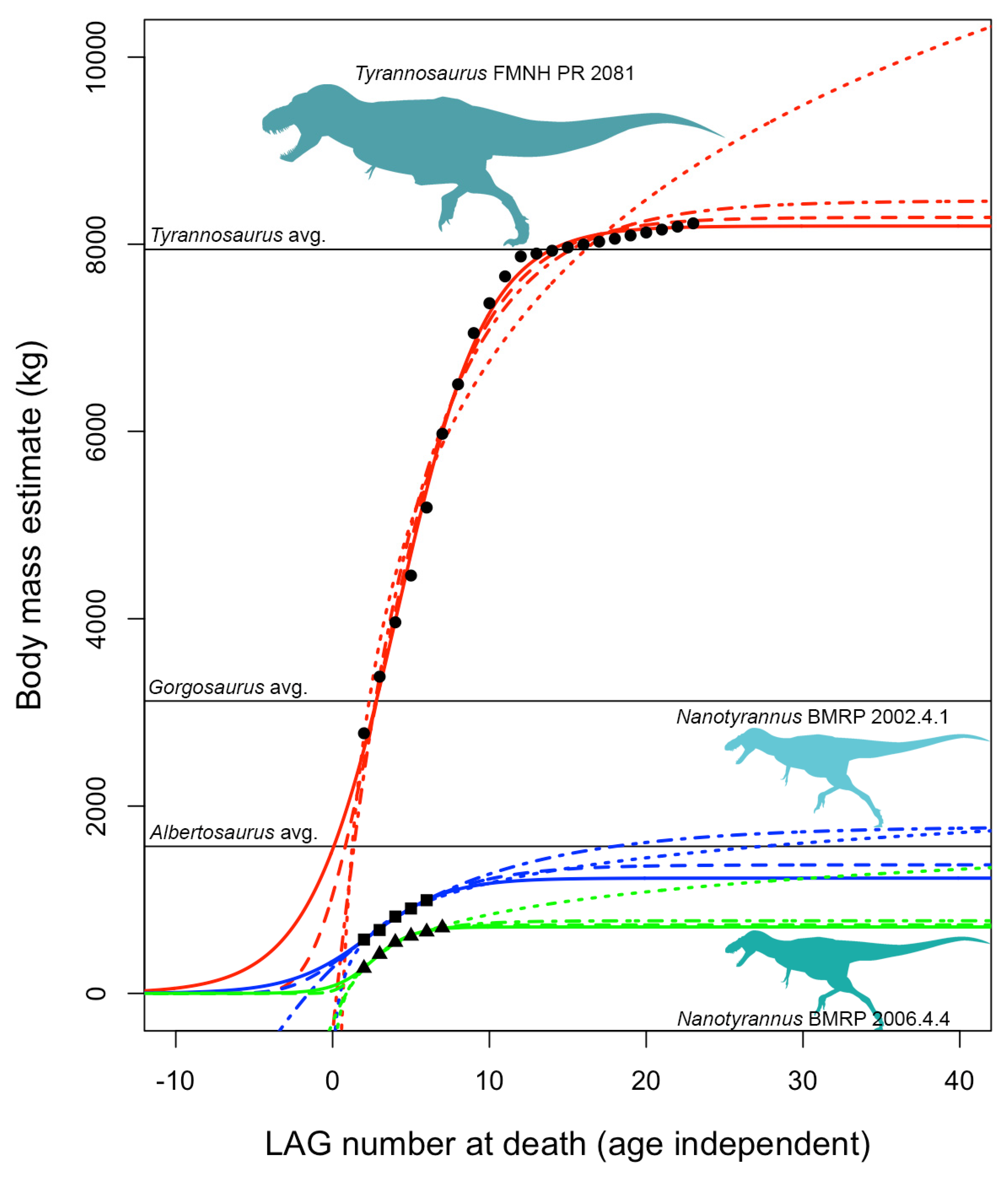

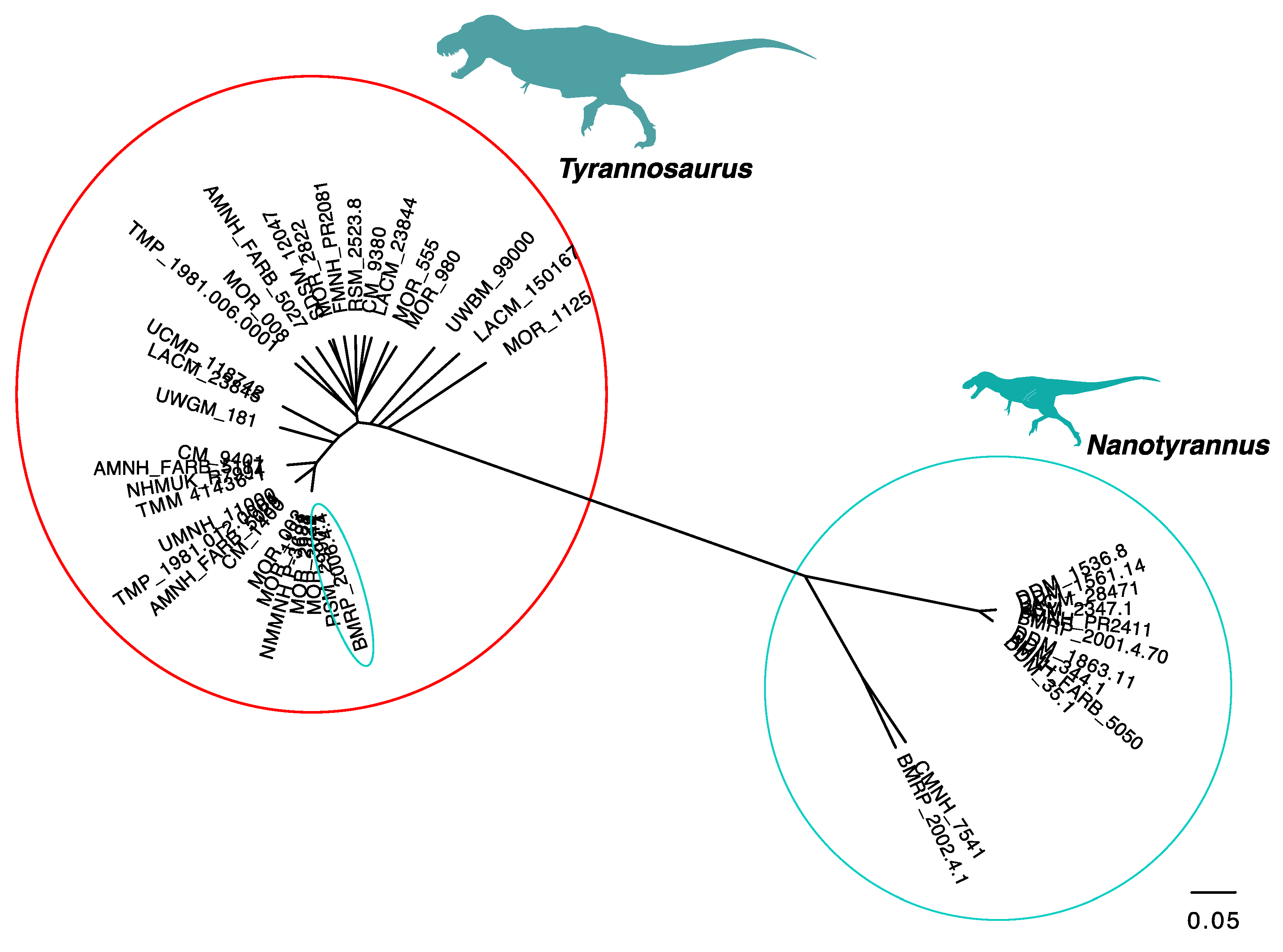

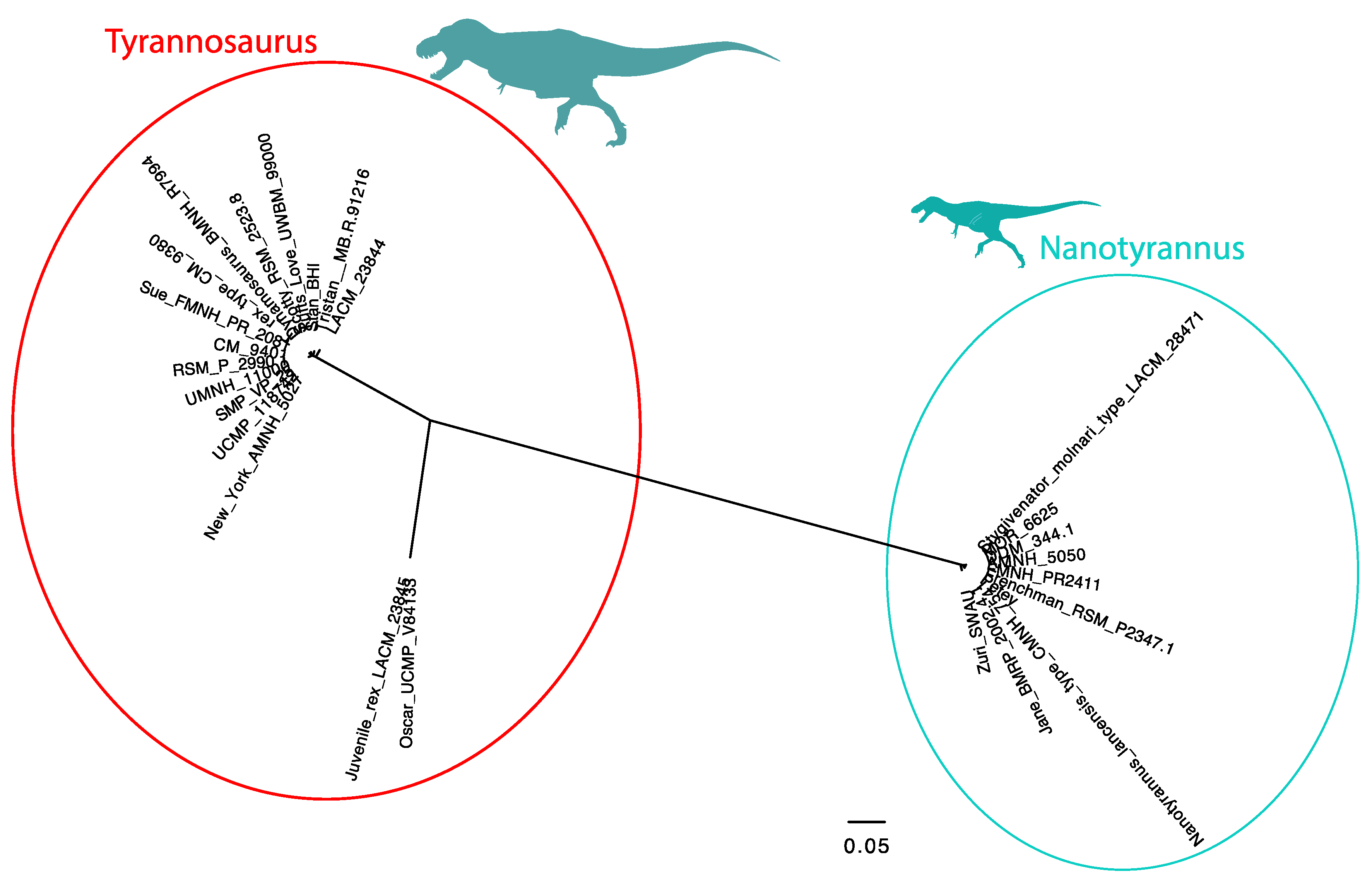

Things of note from this paper (I'm trying to keep an open mind here, even though I know others, including paleontologists prior have found flaws within the data presented, sample size, etc):
-They bring up the controversial matter of Tyrannosaurus potentially having multiple species, and different points brought up from different studies looking at this issue. and stating "We consider this hypothesis viable but in need of further study." I do agree more study is needed, and that there could be potentially be more species out there, but I'm not sure the most recent paper was the most solid in regards to that.
-That the proposed "Nanotyrannus" specimens were not juveniles, but had mature characteristics.
-"Raptorex kriegsteini" was excluded from analysis because it appears to represent a juvenile tyrannosaurine, most likely Tarbosaurus". Wouldn't it have made sense to include it for the purposes of a study such as this? The "Raptorex" specimen has also gone through a controversial classification such as the proposed "Nanotyrannus" specimens. And if they do consider it a juvenile Tarbosaurus, or other  related species, that seems all the more reason why to include it. On a similar note, why not also include both Albertosaurus and Gorgosaurus specimens in something like this (that said later down it does look like they did take a look at Gorgosaurus specimens, but not sure why it wouldn't be mentioned here too)? Prior to stating the above they said this:
"We coded Nanotyrannus lancensis into two previously published character–taxon matrices [1,52] using a composite coding of CMNH 7541, BMRP 2002.4.1, LACM 28471, and the HRS material (Supplementary Information S3, Supplementary Information S4). Coding focused on the skull because the postcrania of BMRP 2002.4.1 are mounted and neither BMRP 2002.4.1 nor BMRP 2006.4.4 are described. Phylogenetic analysis was run in equal-weights parsimony using PAUP* 4.10 b10 [48] (a single character, character 504, was assessed to be potentially redundant and excluded). A second set of analyses was conducted using only ontogenetically stable characters, i.e., characters coding the same in Tarbosaurus adults [53], subadults [34], and young juveniles [54]."
-Another point made is that numerous late Cretaceous formations have been found to have multiple genera of tyrannosaurids, such as Gorgosaurus and Daspletosaurus, and Tarbosaurus and Alioramus, etc, with the Horseshoe Canyon formation being the exception so far (excluding anywhere T. rex is found, since they are proposing "Nanotyrannus" is valid here). They also mention something similar occurs with abelisaurids, of course the Morrison Formation with its variety of large predatory theropods, as well as late Pleistocene mammalian faunas, and extant ones, and marine ecosystems such as during the Miocene with Otodous megalodon and Livyatan, etc, or extant ecosystems with Orca, great whites, etc.
-"Within predator clades, diversity tends to be higher towards the lower end of the mass range; that is, there are fewer species of big cats than small cats, fewer wolves than foxes, many small weasels and ferrets, and just one wolverine [85]. The reasons for these patterns are unknown, but they imply higher speciation rates at low mass, higher extinction at large size, or both. In light of this, one would expect the diversity of small tyrannosaurs to be higher than for large tyrannosaurs." We haven't really seen this so far. The only time we have a smaller tyrannosaur with a larger one is the case of Alioramus and Tarbosaurus. Otherwise it's two large genera, with their various younger forms. And if you go even smaller, well then you have multiple instances of dromaeosaurids and troodontids that occupy a lot of niches in numerous formations, if not ornithomimosaurs and oviraptorosaurs to some degree as well. While Dakotaraptor is likely chimeric, there are some elements that do seem to belong to a large dromaeosaurid, which means at least one medium predator niche was held by a larger dromaeosaurid in at least Hell Creek. However without further study of the material (which likely won't happen knowing DePalma's reputation), or more specimens brought to light, it's hard to say what exactly is going on, and what belongs to what, outside of some twitter and other speculation. The paper does however mention that both Dakotaraptor, and even Acheroraptor are much smaller then T. rex. They do not mention anything about younger tyrannosaurs occupying different niches from the adult forms, which seems like a weird thing to omit. The paper also omits Anzu, Pectinodon, etc, although those are also smaller.
-They suggest that BMRP 2006.4.4 (Petey) clusters with T. rex in their cluster analysis, but also go on to say "This does not seem to result from a strong character signal because (i) the animal lacks cranial material, (ii) the femur was not coded, and (iii) the matrix includes a very large number of subtle characters of the pedal phalanges which (as the material has not been described) we could not verify, but which may drive this pattern. We suspect the placement of BMRP 2006.4.4 is a coding artifact, but further study of the characters and material is needed."
-They plot out tooth length and tooth count, and conclude the two are different. Is this the same argument put forth prior?
-They compare characters in juvenile Tarbosaurus specimens to the proposed "Nanotyrannus" specimens, and suggest there is a possibility they could be juvenile features in the latter, but also state that some of those features are found in adult Alioramus. They state the juvenile Tarbosaurus has features shared between the adult Tarbosaurus and T. rex that the proposes "Nanotyrannus" specimens lack, and "These features appear early in the ontogeny of Tarbosaurus and would presumably occur early in the ontogeny of Tyrannosaurus. The absence of these features in absolutely larger Nanotyrannus specimens is difficult to explain in terms of ontogeny unless Tyrannosaurus had a pattern of development unlike that of Tarbosaurus (Figure 20). Some features of Tyrannosaurinae, especially those related to the skull ornamentation, orbits, and skull roof, appear to develop late, but others appear in even the youngest specimens (Figure 19 and Figure 20). At least some tyrannosaurine features would be expected in Nanotyrannus if it was a juvenile tyrannosaurine, but few, if any, are present." Edit: They claim adult Alioramus exist, but the only specimens I'm aware of are both juveniles? Specifically both the holotype of Alioramus remotus, and A. altai, unless there's specimens out there I'm not aware of, such as potential specimens awaiting description? Specifically they said this, "This means some features seen in Nanotyrannus could conceivably be juvenile characters, but these features do not necessarily mean that the animals are juvenile since they occur in adults of tyrannosauroids such as Alioramus" The papers they link to also only discuss those two juvenile specimens I'm aware of, at least from what I gleaned from quickly skimming them. I'll look at them more in depth tomorrow just to be on the safe side, and see if there any other publications specifically on this genus.
-They also compare juvenile Gorgosaurus specimens to adult Gorgosaurus and state there are similarities, but that the proposed "Nanotyrannus" specimens lack features the juvenile Gorgosaurus specimens have. They suggest that, "For Nanotyrannus to be a juvenile Tyrannosaurus, Tyrannosaurus would have had to have a radically different development pattern than Tarbosaurus or Gorgosaurus. This is not impossible; ontogeny evolves. However, it is more parsimonious to treat Nanotyrannus and Tyrannosaurus as distinct species."
-They also compare the proportions of the manus for the proposed "Nanotyrannus" specimens and T. rex, and conclude that they would need to basically shrink during development.
-They suggest some skeletal features (vertebrae, pectoral girdle, and pelvic girdle, and texture of the skull) in the "Nanotyrannus" specimens show they are close to skeletal maturity, or from young adults, not juvenile animals. They compare these features to other mature, or maturing theropods, including T. rex, and in the case of the skull features, other theropods (mostly tyrannosaurids), and even ceratopsians.
-They suggest an alternative hypothesis for the variation in growth trajectory would be an extreme example of sexual dimorphism (if the specimens are included in T. rex).
-They compare the "smallest unambiguous Tyrannosaurus" LACM 28345 to that of CMNH 7541 (the holotype of "Nanotyrannus"), and ane BMRP 2002.4.1. They also compare UCMP V84133 (T. rex) to the proposed "Nanotyrannus" specimens. Prior to going into detail about doing this, they said, "The hypothesis that Nanotyrannus is a juvenile Tyrannosaurus predicts that the two forms should not overlap in size; that is, all Nanotyrannus will be small, and all Tyrannosaurus will be big. No small Tyrannosaurus should exist. Conversely, if Nanotyrannus is a distinct species, then small juveniles of Tyrannosaurus—approaching the size of Nanotyrannus or smaller—must exist. Juvenile dinosaurs tend to be extremely rare; however, potential juveniles of Tyrannosaurus are known, including a partial skull." So they are only proposing some specimens could belong to a different genus, while confirming some are in fact juvenile T. rex. Yet as we all know that's been very controversial over the years.
-Their phylogenetic placement of "Nanotyrannus" is outside Tyrannosauridae and Tyrannosaurinae, but also finds that Alioraminae is more basal, below "Nanotyrannus". Another dataset shows something similar, with "Nanotyrannus" below Alioraminae, but with Albertosaurinae further down, which would make "Nanotyrannus" a basal member of Tyrannosaurinae. The matrix however shows Bistahieversor outside of Tyrannosauridae. I thought that was accepted to be the case? This is what they claim regarding this, "We repeated our phylogenetic analysis using another dataset, the Brusatte and Carr matrix [1], updated by Wolfe et al. [64]. This matrix produces similar results (Figure 33). Nanotyrannus emerges below Alioraminae but with Albertosaurinae further down the tree. This would make Nanotyrannus a basal member of the Tyrannosaurinae. We note, however, numerous discrepancies between specimens and codings in this matrix, particularly miscodes that appear to force Bistahieversor outside of Tyrannosauridae. This raises issues of whether the backbone of the tree is properly reconstructed; we suspect that the first topology better reflects tyrannosauroid phylogeny..."
These are all the specimens they are referring to "Nanotyrannus" or as close relatives of such (while also noting how many species there are is unclear):

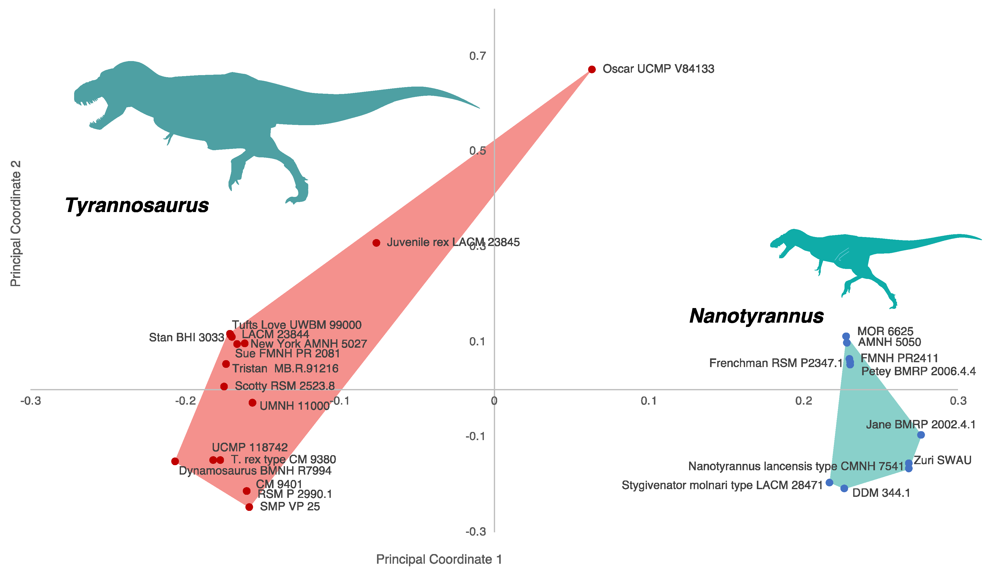

avatar_suspsy @suspsy You claimed "Longrich seriously didn't bother to include the Jane specimen in the study. That's . . . very bad." in an earlier post, but Jane was definitely mentioned throughout the paper, which both avatar_Nyr0r0saurus @Nyrorosaurus and S @SidB pointed out. A simple search brings up the name Jane 19 times, with an additional 31 for BMRP 2002.4.1, which also includes captions for figures and tables. That's quite a bit, so I'm surprised you would claim something like that (and I initially liked your comment, as I had yet to read the paper, and thought your comment was in response to what the paper said, since you claimed as such), which is demonstrably false.
The Jane specimen (BMRP 2002.4.1) is also represented in these images (and others):
Edit: Fixed some spelling (my spell check somehow wasn't working earlier), and italicized some names. Also added an edit pointing out an additional part of the paper in the notes section where they were claiming there were adult Alioramus specimens, which I'm not currently aware of. I'll do more research on this tomorrow.
I was referring specifically to Figure 18, in which the authors used the 13 largest T. rex skulls and a few purported Nano skulls, but omitted Jane completely. Meant to specify that in the first place, but just plain forgot. Been a busy week.
avatar_suspsy @suspsy Thanks for the clarification, and sorry to hear. Hope you can catch a good break afterwards. Looking back at the previous discussion in this thread, I wonder if this is also what avatar_TaranUlas @TaranUlas was getting at, so sorry to single you out in particular in regards to this.
Anyways that is an absolutely strange omission on their part, considering how much of the paper refers to it, or includes it in most sections of the paper. Specifically they plot out Nanotyrannus as having around 16-18 dentary teeth, but the Jane specimen seems to have less then that (when compared to the images in figure 12). Again the plot something similar for the maxillary teeth, but once again the Jane specimen seems to have less then that (when compared to the images in figures 4 and 5). The sample size also seems way too small with only 3 for Nanotyrannus, unless those are the only specimens with decent skull and teeth material. Looking at the referred specimen list above it seems there are more specimens then three that could have been used, but that again depends on how good the material was, however that still doesn't explain why Jane was left out, when it seems to be decently preserved on this front. Hopefully when there is another paper on this topic, that aspect is addressed and corrected (unless a previous paper already did so).
That said where in the paper did they mention what specimens they used for that part of the paper (figure 18)? Was that something in the supplementary material? Edit: Just wondering if I missed something that's all. I spent like all day picking at this paper, with numerous distractions and breaks in between, and I'm not really inclined to do it again, lol. It's possible I also came across it, but already forgot because my short term memory is terrible.
