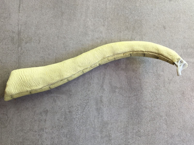

neck: step 2+3
Unfortunately I forgot to make a cut for a hard border (upper side) in advance for the next step (side). So I need to rebuild the boundary.
cheers
Alex

>The level of detail in your sculpts is stunning.
The level of detail is caused by my own skin, from which I took thin silicon molds. And this molds are pressed to the fresh miliput. :-)

I've been on holiday and visited parents in law and thus I worked again on Giraffatitan. I needed to rebuild the neck, because of the sculpt-boundaries. Now it looks far more better:
Cool summer!

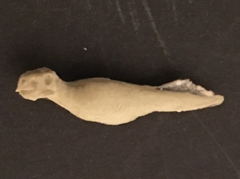

Here we go with the next update. I had been in hospital for 2 weeks, so I had enough time and silence for sculpting. I concentrated on the feet. I am satisfied with those at the frontlegs and partly with the hindlegs. After all I could mount 2 legs at the body again and while watching the elephant walk, I decided to shift the left hind leg a bit forward to get a better impression of Giraffatitan walking. But unfortunately I need to cut off material to match the aligment of the foot.
Beside I put the remaining milliput at Toujiangosaurus (rebuilt of Mr. Krentz Stegosaurus) and Psittacosaurus.
