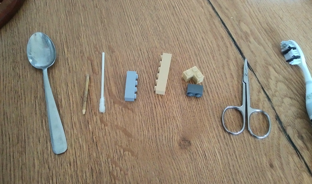

First off, BluStuff needs to be warmed in scalding hot water, so you need a pot and stove or an electric kettle.
These are the tools I use, toothbrush to clean the used BluStuff from old casting material and paint, spoon to get the BluStuff
out of the hot water, plastic bricks to build a general  form (I find that easier and results better, but you could use BluStuff
without these "boundaries"), customized/sanded skewer to press the Stuff tight to the figure, q-tip to use with vegetable oil
(explain later) and scissors to cut off surplus BluStuff.

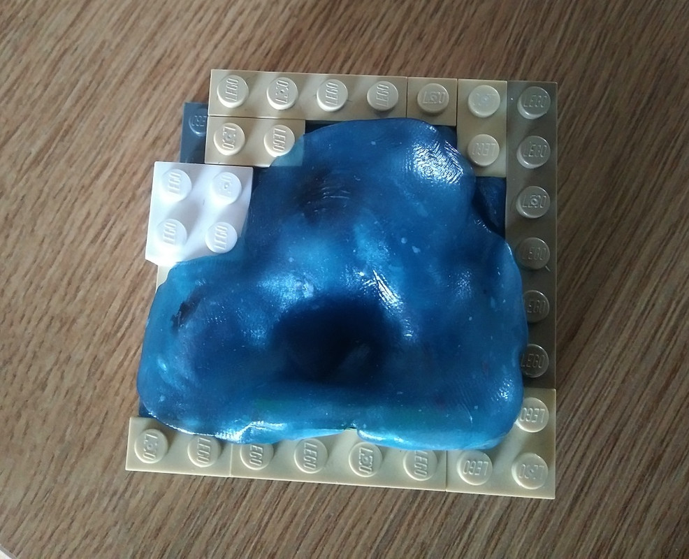

Get the figure you want to duplicate ready and build a generalized form for it. As BluStuff comes in small quantities and you
need at least two parts for a molding mask, you need to consider the size of the figure. The Starlux Diatryma in fact was
already almost too big for the amount of BluStuff I had. So I tried to build the brick form as close to the figure as possible.
Boil water and heat the Blustuff in it. Get half of the BluStuff out of the water and press it into the form. Now carefully press the
figure into the form. You need to work fairly quick while the BluStuff cools as you need to define the figures halves (you can take
the original casting line as guide) and get the BluStuff to fit tight to the figure with the help of the skewer. After you`re done, let
the whole thing cool down properly. I personally cool the form in the freezer. Once it is cooled down get the form out (15 minutes

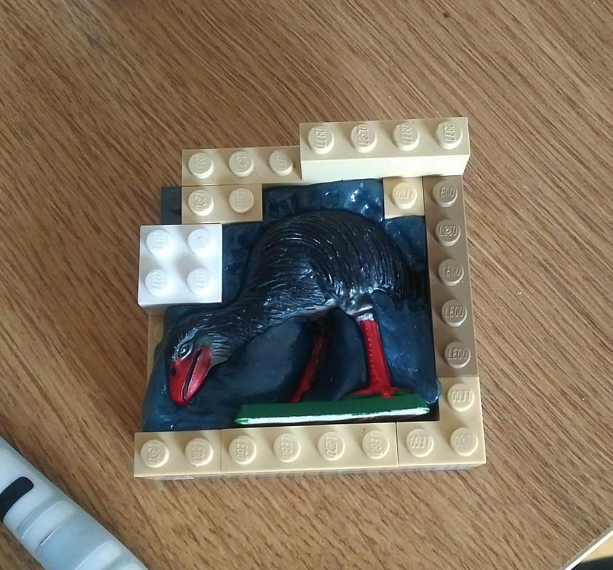

Heat the rest of your BluStuff and then press it tightly over the figure`s upper half. Use the skewer to really get it into every crevice.
Let the whole thing cool down completly, you can use the freezer, but do not need to.

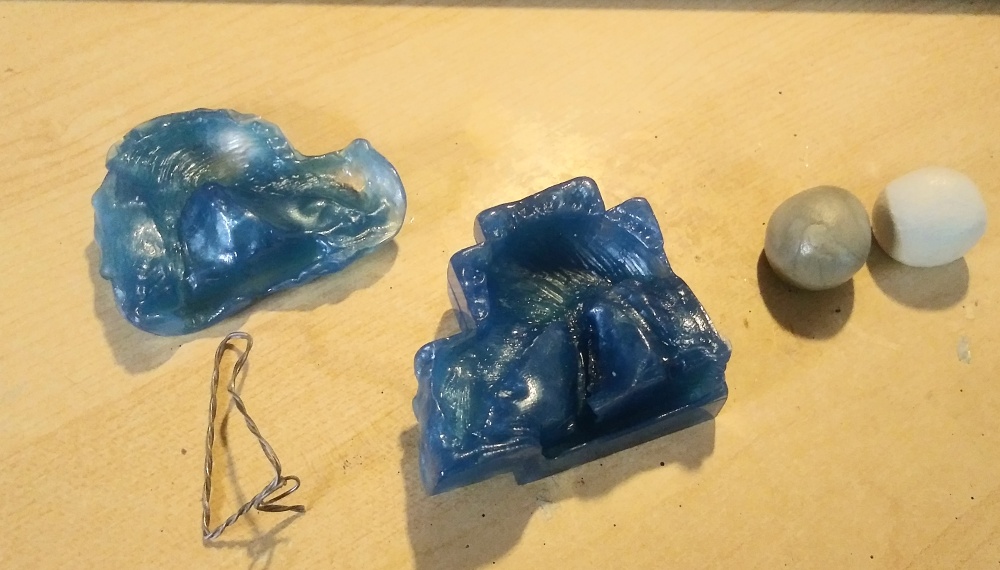

After cooling, build down the brick form and get the whole BluStuff/figure package out. Now carefully seperate the two forms and get
the figure out. Wash figure and both parts of the mold with water and a bit of dish soap to tget rid of the oil.

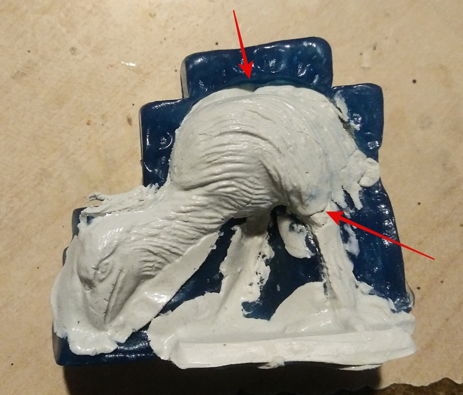

Prepare your casting material - I used Apoxie Sculpt or Fixit Sculpt, but you may use Miliput, GreenStuff or any other other self hardening
material that allows fine detailing. Fill both forms with the casting material carefully and try to use as little as possible, but as much as
necessary. For the legs in the Diatryma I layed in a wire for stability. Once the forms are filled, press the two halves together and
make sure they align corretly (here also helps the use of the brick form before) and do not seperate (I use rubberbands).

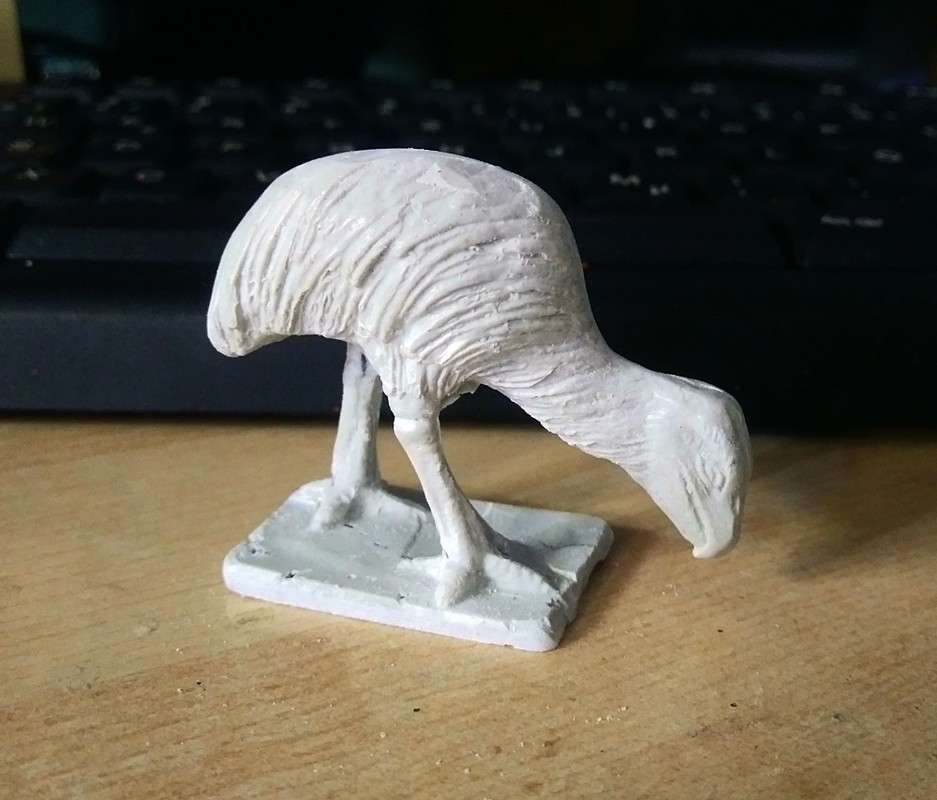

Apoxie Sculpt requires roughly a day to fully cure, but I found it possible and for very delicate figure better to seperate the forms after
8 to 12 hours. Be very carefull in any way, not to break your new figure. As you can see my attempt on the Starlux figure was not perfect,
as the figure was too big for the amount of BluStuff, the 2nd part of BluStuff to cover the figure was very thin and flexible and therefor also
some parts did not have enough casting material in them.

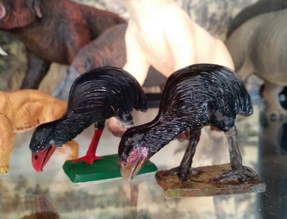

Anyway.... what comes next is cleaning the figure of seams and surpluss material. I use a scalple blade 10 for that (be careful, it cuts deep  >:D)
Last step is painting.... yeah, that is what you get when you use what is sold as "clear coat matt" in German hardware stores... as I said before,
the result needs to be reconsidered :D
