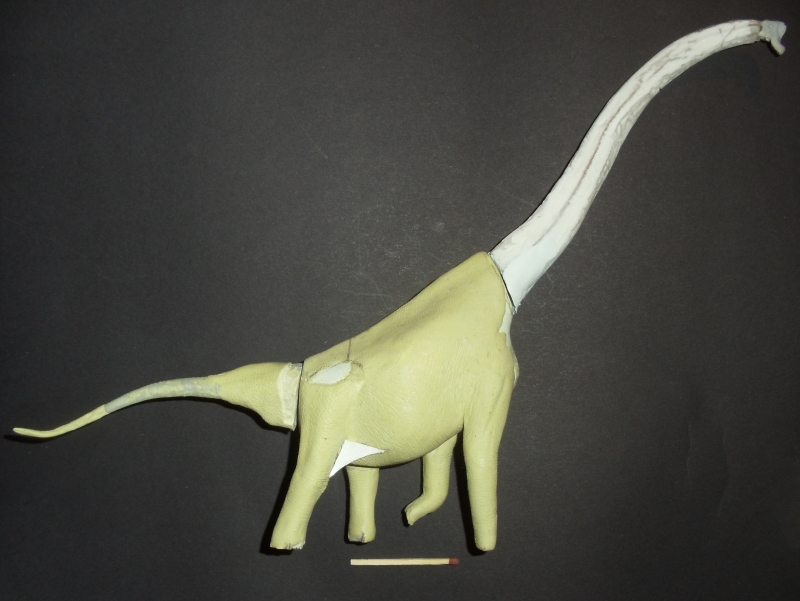

MIXVS MINIMAX
Interstingly I mostly work on Giraffatitan, when I am not at home:
MIXVS MINIMAX
#126
Just a short update. I sanded off the surface of one half of Giraffatitan because I got an idea how to sculpt the unregular wrinkle-network of elephant skin in a hyperultra-realistic way. As I told before, Elephant skin is in my opinion the best skin pattern for big dinos. The first test satisfied me extraordinary.
The other half will follow.
Thanks for the update. While sauropods had scales the overall look on the animal (from a distance) would probably more look like that of an elephant with the size and mass obscuring the scaliness. Knowing the detail on some of your other figures I am sure you are on the right way to produce the best Giraffatitan for that scale :)
